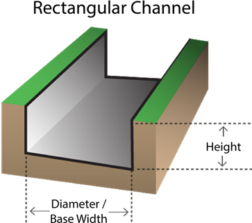

Rectangular Channel is an open channel with a rectangular cross-section. The flow routing through a Channel Connection is described in Analysis of Junctions and Connections.
Parameters to specify:
Length, Slope, either Manning's n or Colebrook-White Roughness, Diameter/Base Width, Height, see Connections Inputs.
