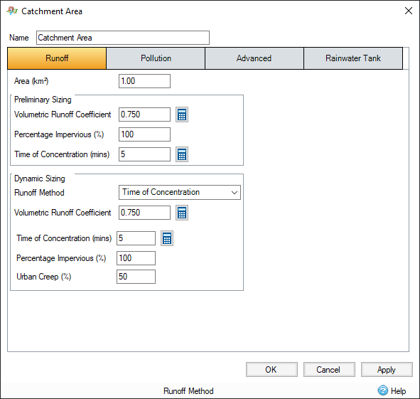

Time of Concentration – The amount of time that it will take for water landing on the roof area to enter the system. The inflows from the area will then be evenly spread over this time when the area is analysed. This amount of time can be calculated with the Time Of Concentration Calculator.
Percent Impervious – The impervious portion of the Inflows area. When the Use Land Uses/Soil Types layers box is ticked, the Percentage Impervious is calculated from weighted averages of Land Uses.
Urban Creep – This scales the impermeable area by the amount specified. This can be used to take the increase of urban areas, or other factors, into account. This value is only enabled (and used) when the analysis creep of the Analysis Criteria is set to "Use Catchment Areas".
