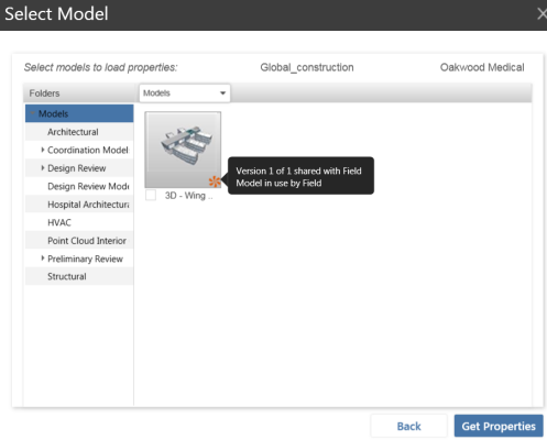

  5. In the Select Model dialog, use the drop-down to filter by either Models or Merged Models.
  6. Under Folders, select a model to load equipment properties added in BIM 360 Field. The Equipment icon indicates that a model contains Field equipment properties.
  7. Click Get Properties. A Process Completed message appears when the properties are loaded.
