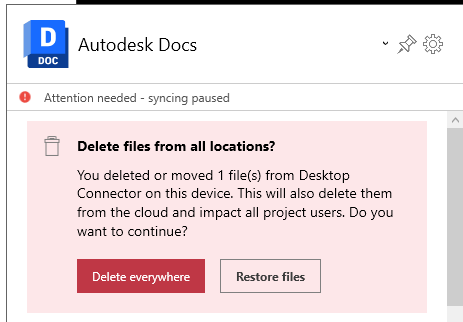

Delete
Right-click a file or folder and select Delete to delete the relevant file or folder from your connector and the cloud data source. After deleting, you will receive a delete confirmation on the Desktop Connector home screen. If confirmed, the deletion removes the file from both your local machine and the cloud.
If you are looking to save space on your local machine, use Free up space instead. Using Delete will remove the file from both the local machine and the cloud.
Warning: Do not delete project-level folders. While the project itself cannot be deleted in the cloud, selecting and deleting a project-level folder will delete all files within that project.
delete notification

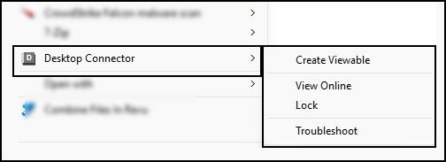

Desktop Connector Right-Click Commands
When Desktop Connector 16.10.x and above is installed, the following commands will be available in the right-click menu.
Note:
The Desktop Connector Right-Click commands will not be shown if Desktop Connector is running elevated as this is not supported. Learn more about Unsupported Workflows
Right click on a file and choose a command from the Desktop Connector menu.
