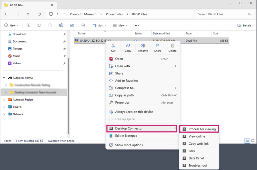

In Desktop Connector
After uploading files using Desktop Connector v16.15 or later, members can:
Select one or multiple files in File Explorer
Right-click and hover over Desktop Connector menu option
Select Process for viewing to process the files for viewing on web or mobile.
This option applies to files only. Folders are not supported.

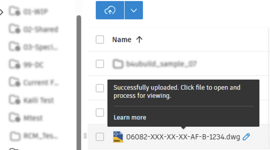

In the Files tool on web
When you click an unprocessed file, processing will start. You can click the file again to enter the viewer to view the file.
You can also bulk process files by selecting multiple files then clicking Process for viewing. See Process for viewing help topic for more information.
