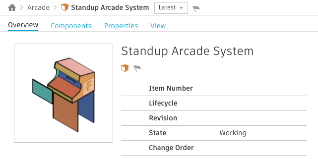

The Components tab displays the assembly structure of a Fusion design. Use the Components tab in the Fusion web client, or in the Home tab if you enabled the Manage extension, to view all of the components in a design.
For more information about this feature preview, see the Fusion 360 Blog.
In the navigation panel, open the project containing the design you want to view.
Select the design.
In the main view, click the Components tab.
The following columns display by default:

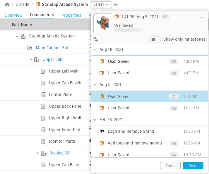

Use the History menu to view a different version of the design. The components for the selected version display in the Components tab.
Click the History menu.
Select a version from the list.
Click Go to.
You can filter the history to show only design versions that are milestones.

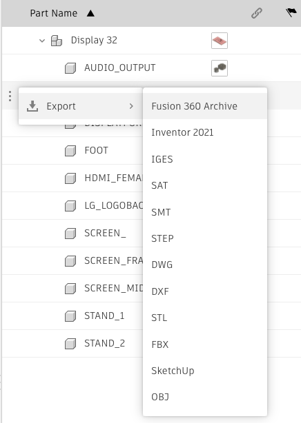

Place the mouse pointer over the component to export.
Click the Action menu and then select Export.
Select the format.
