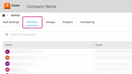

  1. Open the Fusion web client.
  2. Click your profile image in the top-right corner, then select Admin.
    Admin menu option highlighted in profile flyout
  3. Go to the Members tab.
    Members and groups tab
  4. In the Status column, check to see if the recently invited members have accepted their invitations and can be assigned licenses:
    • Pending: Members haven't accepted the invitation yet.
    • Active: Members have accepted the invitation, joined the hub, and can now be assigned a license.

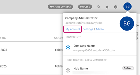

  2. Click your profile image in the top-right corner of the page and select My Account, or go to manage.autodesk.com.
    My Account

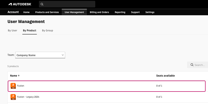

  3. In Autodesk account management, go to User Management > By Product.
    user management
  4. Click Fusion.
    fusion in user management
    This shows the number of licenses (seats) available, the total number of licenses, and, under Assigned users, people who have had licenses assigned to them so far (if any).
