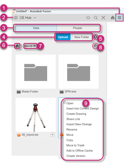

Data Panel controls
data panel ui overview
  1. Data Panel show or hide: Show or hide the Data Panel.
  2. Current hub: The current Fusion hub you're working in.
    Note: The hub name is displayed at the top of the data panel. Check for this icon collaborative editing next to the hub name to confirm if you're working in a collaborative editing hub.
  3. Data or People: Switch between the Data or People views.
  4. Upload or New Folder: Upload a file from you local device or create a folder in the current project.
  5. Settings: Customize and sort the Data Panel view; for example show data in a grid, or sort it by name.
  6. Return to the project list: Go back to the list of projects, libraries, and samples.
  7. Current project: The name of the project or library you're currently working in.
  8. Open on the Web: Open the current project or library in the Fusion web client.
  9. Context menu: Right-click to access commands for that specific project or folder.
