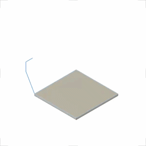

Create an edge flange
  1. Repeat steps 1-2 from the Create a base flange task.
  2. On the canvas, select one or more edges on a sheet metal body.
  3. Specify how the flange extends:
    • Distance (default): Specify the Height to extrude the flange from the height datum:
      • On the canvas, drag the distance handle.
      • Or specify an exact value.
    • To object: Extend the flange until it meets a selected face, plane, or body. This option is only available when you select a single edge, as multiple edges can extend in different directions and Fusion cannot determine where to extend. The target object must be planar (cannot be round or curved) and must lie on a plane that is parallel to the edge being extended.
      1. In the Flange dialog, set Extent type to To object.
      2. On the canvas, select the face, plane, or body to extend to.
      3. (Optional) Specify an Offset value to offset the flange from the selected target object.
  4. Specify the Angle of the flange relative to the selected sheet metal edges:
    • On the canvas, drag the rotation handle.
  5. In the selection box, select a Flange width type for each selected sheet metal edge, and adjust its associated settings below the selection box:
    • Full edge full edge icon: Creates a flange along the entire length of the selected edge.
    • Symmetric symmetric icon: Creates a flange of a specified distance centered on the mid-point of the selected edge.
      • Distance: Specifies the overall distance of the flange, centered on the mid-point of the selected edge.
    • Two sides two sides icon: Creates a flange centered on the mid-point of the selected edge with two adjustable width extents on both sides.
      • Distance 1: Specifies the distance to extend one side of the flange from the mid-point of selected edge.
      • Distance 2: Specifies the distance to extend other side of the flange from the mid-point of selected edge.
    • Two offsets two offsets icon: Creates a flange positioned between two selected reference faces, with adjustable offsets from each face.
      • Reference 1: Select a face, point, or plane to define the reference for one side’s offset.
      • Offset 1: Specifies the distance from Reference 1 to extend the flange on one side.
      • Reference 2: Select a face, point, or plane to define the reference for the other side’s offset.
      • Offset 2: Specifies the distance from Reference 2 to extend the flange on other side.
  6. (Optional) If you selected Distance as the extent type, select the Height datum to measure the flange height:
    • Inner faces inner faces icon: Sets the height reference to the intersection on the inner faces of the base flange and the new flange.
    • Outer faces outer faces icon: Sets the height reference to the intersection on the outer faces of the base flange and the new flange.
    • Tangent to bend tangent to bend icon: Sets the height reference tangent to the bend between the base flange and new flange, parallel to the new flange.
  7. Select the Bend position:
    • Inside inside icon: Places the bend inward, so it starts inside the outer edges of the base and new flange.
    • Outside outside icon: Places the bend so it extends beyond the inner edges of the base and new flange.
    • Adjacent adjacent icon: Places the bend so that it starts at the selected edge on the flange.
    • Tangent tangent icon: Places the bend so that it is tangent to the selected edge on the flange.
  8. (Optional) If you selected Distance as the extent type, you can Flip flip icon the flange 180 degrees over the base flange.
  9. (Optional) Select Miter corners to miter the corners where sheet metal corners would otherwise overlap.
  10. (Optional) Select Override rules to change one or more default values from the Sheet metal rule for this operation only. This does not change the values in the Sheet metal rule itself.
  11. Click OK.
    The flange is added to the sheet metal body on the canvas. An Edge flange edge flange icon feature appears in the Timeline.
