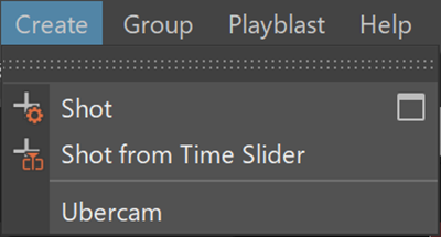

Create a shot using the Sequencer toolbar
To create a shot:
  • In the Sequencer toolbar, click the Create Shot button.
This is the primary method for creating shots. The behavior of the Create Shot button depends on how it is accessed.
  • Left-click creates a shot using the current range settings. This is the default behavior.
  • Click the caret next to the Create Shot button to open the flyout menu and access additional shot creation options, such as creating a shot from a selected Time Slider range or using the Create Shot Options window.

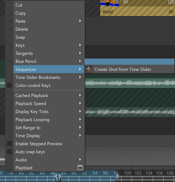

Create a shot from the Time Slider context menu
You can create a shot directly from a selected frame range in the Time Slider using the context menu.
To create a shot from the Time Slider:
  1. In the Time Slider, Shift-drag to select a range of frames.
  2. Right-click the Time Slider to open the context menu.
  3. Select Sequencer >Create Shot from Time Slider.
A new shot is created in the Sequencer editor using the selected Time Slider range as the shot's start and end frames.

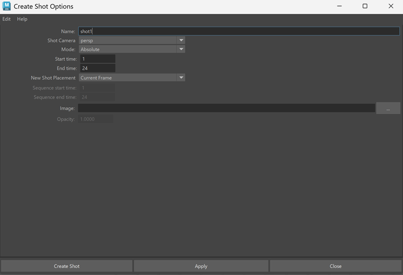

Create a shot using Create Shot Options
Use Create Shot Options to create shots with specific start and end frames or a defined duration.
To open the Create Shot Options window:
  1. In the Sequencer toolbar, click the caret next to the Create Shot button.
  2. Select Create Shot > .
The Create Shot Options window opens.
Absolute mode
Use Absolute mode to manually specify the start and end frames for a new shot. The current playhead position is not used.
  1. Select Absolute Mode.
  2. Enter values for Start Frame and End Frame. (If the End Frame value is less than the Start Frame value, it is automatically set to Start Frame + 1.)
  3. Click Create.

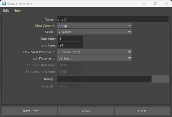

Relative mode
Use Relative mode to create a shot with a specific duration starting at the current playhead position.
  1. Select Relative Mode.
  2. Enter a value in the Duration field.
  3. Click Create.
The new shot is created with a range from the current playhead frame to the playhead frame plus the specified duration.
