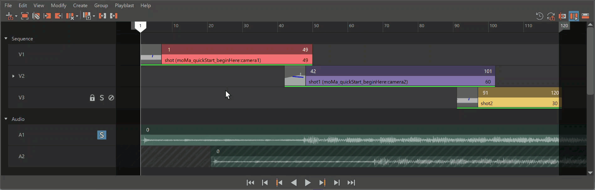

Create transitions between shots on multiple tracks
To create a transition:
  1. Select a shot.
  2. In the Attribute Editor, expand Transition Attributes.
  3. Set Transition In Type or Transition Out Type to the desired transition.
The following transition types are available:
  • Fade
    Creates a fade to or from black on the selected shot.
  • Dissolve
    Creates a cross-dissolve between the selected shot and the next top-most shot on the track beneath it in the Sequencer editor.
