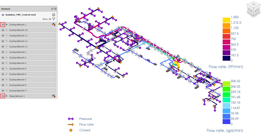

Display the HVAC and Piping Systems
In this task, you will display the flow rate results for the ducting and the piping networks. In order to distinguish between the ducting and piping results, two legends are available.
  1. Click next to Ducting Network 1 to display it.
  2. Ensure that Piping Network 1 displays too.
