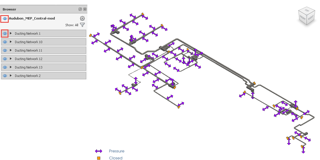

HVAC: Isolate the Main Supply Ducting Network
The Browser displays a list of several ducting networks, but you will focus on the primary supply ducting network, and you will hide other systems.
  1. Click next to the model name in the Browser to hide all the networks.
  2. Click again for Ducting Network 1 to display this network only.
