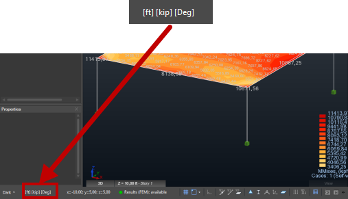

The status bar indicates which type of units and system you are using.
For example the status bar below indicates that the current project uses the imperial system based on distances expressed in feet [ft], forces expressed in kip [kip], and angles expressed in degrees [Deg].
Tip: Double-click the units in the status bar to open the Units and Formats settings.
