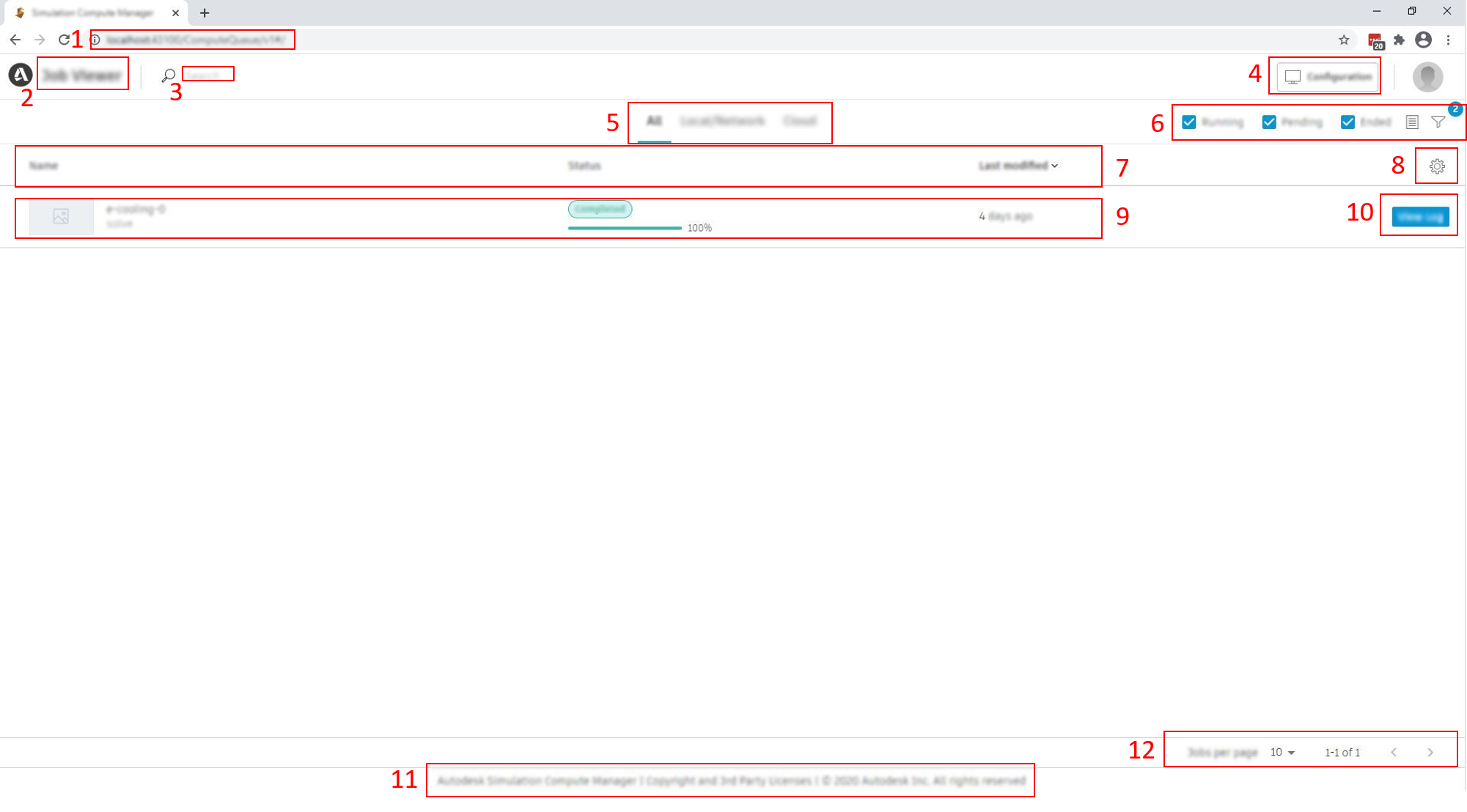

The Job Viewer
- Job Viewer address. http://localhost:43100/ComputeQueue/v1#/.
- Current page, defaults to Job Viewer.
- Search for a job(s).
- Switch to Configuration page.
- Switch between job filter tabs. All, Local/Network, or Cloud.
- Manage view filters.
- Job information columns (configurable in (6)).
- Manage Job Viewer settings.
- View Job information
- Cancel job or view logs
- View License and copyright information
- Manage pagination settings.
