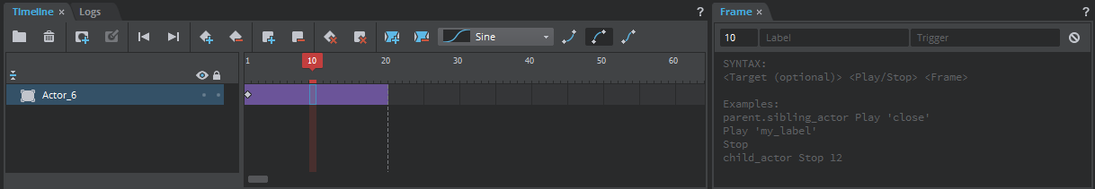

When the container is an Animation component, each actor is able to define their own timeline. A timeline consists of empty frames and keyframes. Empty frames indicate frame positions where the actor does not exist on the timeline. A keyframe defines a change in the display transform or color transform of the actor, and keyframes can span many frames. They are shown as gray blocks in the timeline track view. However, the state of an actor that is being tweened is defined by its tweened values.
Tweens are smooth transitions between two keyframes, and are defined by a transition function and easing value. They are shown as purple blocks in the timeline track view. Tween properties such as the tween transition type and the easing type are set using the Timeline tween controls, at the top of the timeline view. Tweens allow you to create smooth transitions between key frames. Changes to these properties are applied to the selected frames.
The red box at the top of the timeline view is the scrubber. You can move the scrubber across the timeline to update the timeline playhead, and the stage will update all child actors to their state at the playhead position. You can also associate labels, triggers and actions with a playhead location from the frame controls in the Frame panel. Changes to these properties are applied to the current playhead position.
The playhead can be moved in code using frame numbers. However, frames can be marked with a label to help better organize the content, and the label can then be used to move the playhead. Labels appear as a green marker on the top most track.
Triggers are invoked when the playhead reaches the frames containing them. These triggers can be handled in code for generating complex behavior and composite animations. Actions such as Stop, Play allow you to control the playhead behavior without writing any code. Triggers and Actions appear as a yellow marker on the top most track.

Now, translate or transform the actor at frame 20, by changing its properties in the Properties panel or by using the select or transform tool. This will affect the object only at the current keyframe; in this case frame 20. Move the red timeline scrubber from one key frame to another to view the transformations applied. To set a smooth transition of the actor between two key frames, select a frame between the two key frames and then set the Tween transition and easing types to a value other than Unknown. Click Add Tween to add a tween, select a transition from the tween drop-down and click one of the easing type.The first keyframe block color changes from gray to purple indicating that there is a tween from the first keyframe to the next keyframe.
Some of the most commonly used tween transitions are
  1. Linear - this produces a smooth line transition (note that easing has no effect for Linear tweens)
  2. Sine (EaseIn) - the animation starts slow and then speeds towards the end.
  3. Sine (Ease Out) - the animation starts quickly and then slows towards the end.
  4. Sine (Ease In & Out) - this produces a smooth gradual start and end to the animation.
