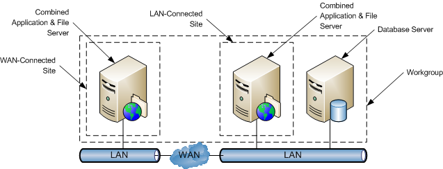

You can replicate file stores from one site to another site. This process is managed by one Microsoft SQL database. The configuration used in replication is known as a workgroup. The following illustration shows a typical workgroup configuration. All sites in a single workgroup share the same Microsoft SQL server.
