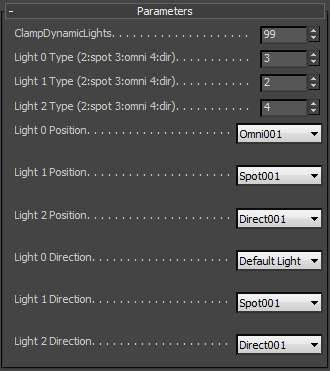

Light Controls on the Parameters rollout
Light controls for a ShaderFX shader appear on the Parameters rollout in the Material Editor. (These are the only controls on the rollout unless you add custom nodes; see Adding ShaderFX Nodes to the Material Editor.)
ClampDynamicLights
Dynamically sets the number of lights used by the shader. Range: 0–99. Default=99.
The ShaderFX shader can have no more than three lights, so a ClampDynamicLights value greater than 3 is equivalent to 3. Change ClampDynamicLights to 1 or 2 to reduce the amount of lighting used. A value of 0 turns off lighting altogether.
Light 0 Type / Light 1 Type / Light 2 Type
Sets the type of each light, as the label describes. A value of 2=spotlight, 3=omni light, 4=directional light. Default=3.
Important: For lights to work correctly, the Position and Direction fields must match the Type of light you choose. (There is no need to change Direction for an Omni light.)
Light 0 Position / Light 1 Position / Light 2 Position
Use the drop-down list to have the shader light derive its position from a light object in the 3ds Max scene.
Light 0 Direction / Light 1 Direction / Light 2 Direction
Use the drop-down list to have the shader light dirive its direction from a light object in the 3ds Max scene.
This choice has no effect if the light type is Omni (3).
