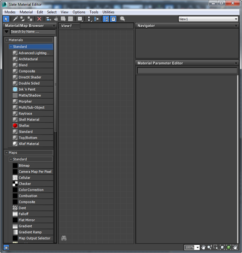

- When you have decided on a material type, open the Slate Material Editor.
Slate Material Editor window
Left: Material/Map Browser panel
Middle: The active View (you can set up more than one View)
Lower right: Parameter Editor panel
- Drag a material of the type you want from the Material/Map Browser panel to the active View.
3ds Max displays the material as a node in the active View.
Example of a material node

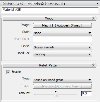

- Double-click the material node to display its parameters in the Parameter Editor panel.
- Use the Parameter Editor to enter settings for the various material components: diffuse color, glossiness, opacity, and so on.
Material parameters in the Parameter Editor
(Double-click a node to display the node’s parameters)
