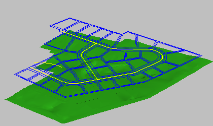

- LandXML/DEM Model Import lets you import land development data into 3ds Max.
- Civil engineering data, from XML, DEM (digital elevation model), or DDF files, is used to create a 3ds Max model.
- The LandXML/DEM Model Import dialog allows for interoperability with Autodesk products such as Land Development Desktop 3, Land Development Desktop 2005, Civil 3D™, and CAiCE Visual PE. Once imported, the models are ready for high-quality photorealistic rendering and animations.
