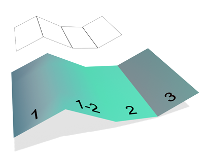

Smoothing blends the shading at the edges between faces to produce the appearance of a smooth, curved surface. You can control how smoothing is applied to a surface so your objects can have both smooth surfaces and sharp, faceted edges where appropriate.
The face labeled “1–2” shares smoothing groups with adjacent faces, so the edges between them are smoothed over in renderings.
The face labeled “3” does not share a smoothing group, so its edge is visible in renderings.
Smoothing does not affect geometry. It affects only the way geometry is colored when rendered.
