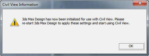

Initialize Civil View. 3ds Max displays an initialization dialog. After you choose the initialization settings and click OK, a dialog warns you to restart 3ds Max.
Click OK to close the warning, then close and restart 3ds Max to begin using the Civil View features.
