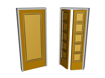

The Pivot door is hinged on one side only. You can also make the door a double door, with two door elements, each hinged on its outer edge.

Single and double pivot doors
