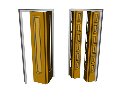

BiFold Door
The BiFold door is hinged in the middle as well as on the side. It has two door elements. You can also make the door a double door, with four door elements.
  • Create panel > (Geometry) > Doors > Object Type rollout > BiFold button
  • Default menu: Create menu > AEC Objects > BiFold Door
  • Alt menu: Objects menu > Architectural Parts > BiFold Door
Single and double bifold doors
