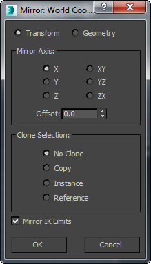

The Mirror dialog uses the current reference coordinate system, as reflected in its name. For example, if Reference Coordinate System is set to Local, the dialog is named Mirror: Local Coordinates. There is one exception: If Reference Coordinate System is set to View, Mirror uses Screen coordinates.
As you adjust the various settings in the Mirror dialog, you see the results in the viewports.

3ds Max opens the Mirror dialog.
- Set the mirror parameters in the dialog and click OK.
The active viewport changes to show the effect of each parameter as you set it. When you click OK, 3ds Max creates the choice of mirror that you see previewed.

The title bar of the dialog shows the coordinate system currently in use.
- Transform/Geometry
- Determines how Mirror treats the reflected geometry.
- Transform Uses the legacy mirror method, which mirrors any world-space-modifier effects.
- Geometry Applies a Mirror modifier whose transformation matrix matches the current Reference Coordinate System setting.
Note: This option does not mirror any world-space-modifier (WSM) effects. This is suitable if you want the mirrored object to react properly to non-mirrored WSMs.
In the following illustration, the car is first mirrored, cloned, and offset in the World coordinate system with the Transform option (top-left) and the Geometry option (top-right). The bottom half of the illustration depicts the same process using the Local coordinate system.
Mirror Axis group
The mirror axis choices are X, Y, Z, XY, XZ, and YZ. Choose one to specify the direction of mirroring. These are equivalent to the option buttons on the Axis Constraints toolbar.
- Offset
Specifies the distance of the mirrored object's pivot point from the original object's pivot point.
Clone Selection group
Determines the type of copy made by the Mirror function.
- No Clone (The default.) Mirrors the selected object without making a copy.
- Copy Mirrors a copy of the selected object to the specified position.
- Instance Mirrors an instance of the selected object to the specified position.
- Reference Mirrors a reference of the selected object to the specified position.
If you animate the mirror operation, mirroring generates a Scale key. If you set Offset to a value other than 0.0, mirroring also generates Position keys.
- Mirror IK Limits
Causes the IK constraints to be mirrored (along with the geometry) when you mirror the geometry about a single axis. Turn this off if you don't want the IK constraints to be affected by the mirror command.
