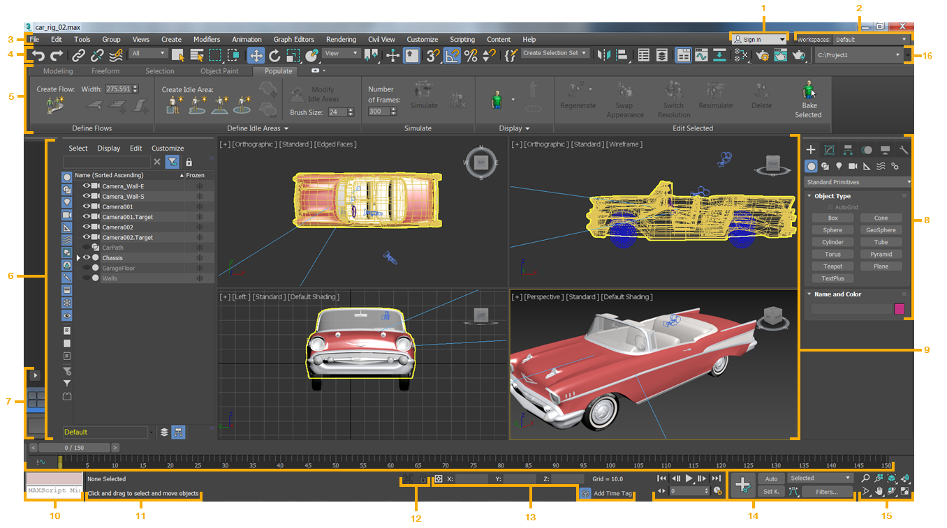

The 3ds Max interface comprises controls, status information, and viewports, where you work and view your scene.
One of the most important aspect of using 3ds Max is its versatility. Many program functions are available from multiple interface elements. For example, you can open Track View for animation control from the Main toolbar as well as the Graph Editors menu, but the easiest way to get to a specific object's track in Track View is to right-click the object and then choose Track View Selected from the Quad menu.

  1. User Account menu
  2. Workspace selector
  3. Menu bar
  4. Main toolbar
  5. Ribbon
  6. Scene Explorer
  7. Viewport Layouts
  8. Command panel
  9. Viewports
  10. MAXScript Mini Listener
  11. Status line and Prompt line
  12. Isolate Selection toggleand Selection Lock toggle
  13. Coordinate display
  14. Animation and Time controls
  15. Viewport Navigation controls
  16. Projects toolbar
