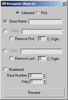

Rename Objects Tool
The Rename Objects tool helps you rename several objects at once.
  • Default menu: Tools menu > Rename Objects
  • Alt menu: Edit menu > Object Properties > Rename Objects
Interface
Selected
When chosen, renaming affects currently selected objects.
Pick
Click to open the Pick Objects To Rename dialog, which lets you choose the objects to rename. This dialog has the same controls as Select From Scene.
Base Name
Enter a base name for all objects. The toggle enables or disables this name.
Prefix
When on, lets you enter a string that will be a prefix to the name of all renamed objects.
Remove First N Digits
When on, the first N characters in the base name are removed from object names. The spinner sets the value of N.
Suffix
When on, lets you enter a string that will be a suffix to the name of all renamed objects.
Remove Last N Digits
When on, the last N characters in the base name are removed from object names. The spinner sets the value of N.
Numbered
When on, lets you number object names incrementally.
  • Base Number The base number appended to the name of the first renamed object.
  • Step The step by which the base number is incremented in succeeding renamed objects.
Rename
Click to rename the affected objects and have your changes take effect.
