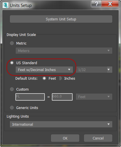

  1. On the menu bar, choose Customize Units Setup.
    The Units Setup dialog appears.
  2. In the Display Unit Scale group, choose US Standard, if necessary.
    Set the scale to Feet w/Decimal inches, if necessary.
    Note: Leave the System Unit Setup as it is. This should be changed only to reset the system unit to the default setting (inches) after loading a file that uses a different system unit, or if you are working on files that are so huge or so tiny that values don't appear correctly in the numeric entry fields.
  3. Click OK to accept the change.
    Now, when you make something, its measurements are displayed in the command panels in familiar real-world terms.

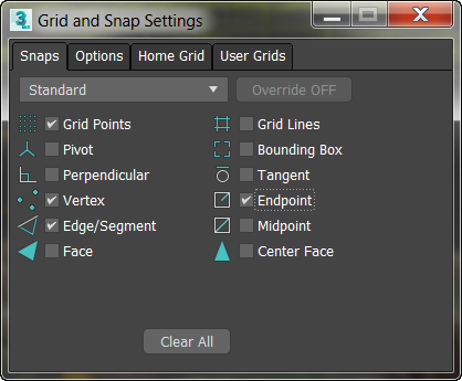

  1. On the main toolbar, right-click (3D Snaps Toggle).
    3ds Max opens the Grid And Snap Settings dialog.
  2. On the Snaps panel, turn on Grid Points, Vertex, Edge/Segment, and Endpoint. Make sure all the other snaps are turned off.
  3. Close the dialog.
    Now, when Snap is on, you'll be able to snap to vertices, grid points, and edges.
    Note: Unlike unit settings, snap settings are not saved with a scene, though 3ds Max does remember them from session to session.

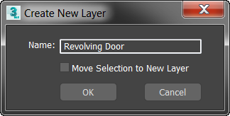

  3. Use the Create New Layer dialog to name the Layer Revolving Door, and then click OK.
    Tip: If 3ds Max creates the layer without opening the Create New Layer dialog, then open the Layers drop-down list, right-click the new layer, and use the Rename Layer dialog to give it the name you want.
    The Revolving door layer is now current and visible in the Layers toolbar. Whatever you create now will be on this layer.

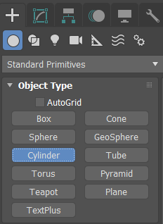

  3. On the Create panel, activate (Geometry). Make sure Standard Primitives is chosen in the drop-down list, then on the Object Type rollout, click to activate Cylinder.
    The Cylinder button highlights to indicate it is active and ready for use.

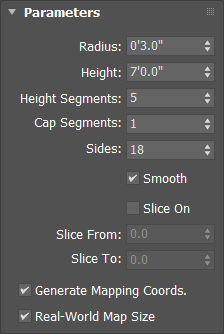

  1. On the Parameters rollout change the Radius value to 0' 3.0", then change the Height to 7' 0.0".
  2. In the Navigation controls, click (Zoom Extents).
    The viewport zooms so you can see the entire cylinder.

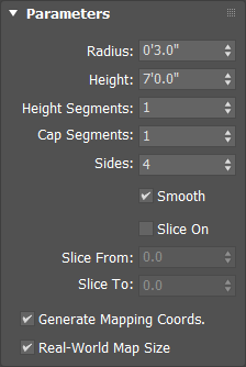

  3. On the Parameters rollout, change Height Segments to 1, then change Sides to 4.
    Tip: The lowest possible Height Segments value is 1. You can minimize the value of a numeric field by right-clicking the spinner arrows to the right of the field where you can type.
    The Cylinder changes into a tall box with four sides; this will make it easier to create the door. Later you'll change the pole back to a cylinder.
