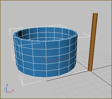

Create the tube:
- On the navigation controls, click
(Zoom Extents) to zoom back so you can see the area around the cylinder.

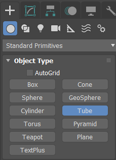

- On the
Create panel
Object Type rollout, click to activate Tube.
The Tube button highlights, indicating it is active and ready for use.
- Drag out a tube anywhere in the viewport.
The size doesn't matter; you'll be changing it in a moment.

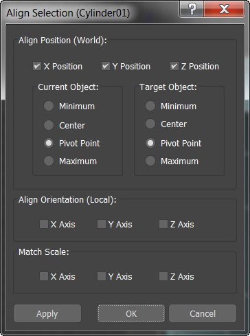

The tube is already selected, so you'll align it to the cylinder.
- Click the cylinder in the viewport.
- In the Align Selection (Cylinder01) dialog
Align Position (World) group, turn on X Position, Y Position, and Z Position. Choose Pivot Point for both Current Object and Target Object. Click OK.
The tube is centered over the cylinder.

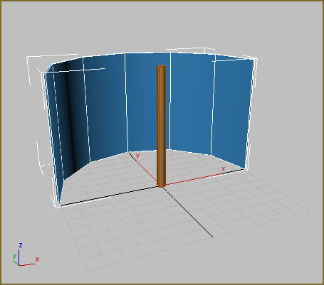

Slice the tube:
- Go to the
Modify panel.
- On the Parameters rollout, turn on Slice On.
- Adjust the Slice From and Slice To values so you have a half of a tube visible in the viewport, resembling the illustration. Set them to
90.0 and
–90.0 degrees.
Slice the tube
- Change Sides to 6. The enclosure will be created out of flat panels, rather than curved glass.
- Change Height Segments to
1.
Reduce the number of faces.

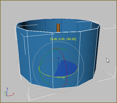

Clone the tube:
- On the main toolbar, click to activate
(Select And Rotate).
- On the keyboard, press A to turn on Angle Snap.
- Hold down the
Shift key and rotate the left enclosure 180 degrees about the Z axis.
A copy of the tube rotates into place on the other side of the enclosure.
- When the copy of the tube is in the proper position, release the mouse button.
3ds Max opens the Clone Options dialog.
- On the dialog, set the Object option to Copy and name the clone
right enclosure panels. Click OK.
