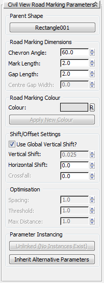

Parent Shape group
[parent shape button]
Displays the name of the current parent shape for the road-marking object. Click to choose an alternative parent shape. Civil View updates the road-marking object.
Road Marking Dimensions group
Chevron Angle
Sets the angle of the chevrons relative to the bearing of the parent shape at the first point in the spline.
Mark Length
Sets the width of the road-marking chevrons or stripes generated across the closed boundary of the parent shape.
Gap Length
Sets the width of the gap between each chevron or stripe. Valid only if the Fill Closed Shapes option is activated on the Road Markings Style Editor. If a solid filled area of marking is required, set this value to 0.0.
Centre Gap Width
Not available for chevron road markings.
Road Marking Color group
Color
Click the color swatch to open the Color Selector and choose a new color for the road-marking line.
"R" button: Reset Color
Click to reset the color of the road-marking line back to the default color specified on the Civil View Preferences panel.
Apply New Color
Click to update the road-marking line to use the new color.
Shift/Offset Settings group
Use Global Vertical Shift?
When on, uses the global Vertical Shift setting.
When a road marking is draped across a ground surface, to be visible it must be raised above the underlying surface slightly. The Scene Settings rollout has a global setting for this. Occasionally, individual road-marking objects need to be raised by a greater amount to cater for unusual contours in the underlying ground surface. When this happens, turn off Use Global Vertical Shift, and set a local value.
Note: In Civil View, shadow casting is automatically disabled for all road-marking objects. Even though road markings are always a small distance above the underlying ground surface, they don't cast shadows.
  • Vertical Shift Set a local vertical shift value for the road-marking object. Disabled unless you turn off Use Global Vertical Shift.
Horizontal Shift
Sets a horizontal offset for the road-marking object, relative to the parent shape.
Crossfall
Optimization group
Not applicable to filled-area chevron road-marking objects.
Parameter Instancing group
Allows the parameters of a collection of objects of the same basic type to be shared or instanced.
See Parameter Instancing for further details.
