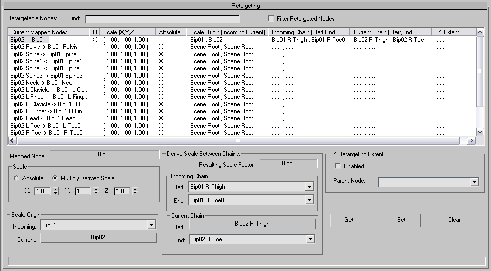

- Go to the Retargeting rollout.
- In the Scale Origin group, choose both the Incoming and Current root objects.
If the characters are symmetrical and have the same proportions, you can now choose all the mapped tracks in the Retargetable Nodes list. If the characters are not symmetrical, or their proportions are different, then you need to take further steps.
- In the Derive Scale Between Chains group, choose the Start and End nodes of both Incoming and Current chains to correspond to either the left or right leg of the character: for example, Thigh to Toe.
Read the Scale Factor that is set on the basis of the two chains.
- Click Set to retarget the highlighted mapped tracks.
If the two current legs are not the same length, repeat step 5 for the other leg, then choose that leg's Foot (or Toe) node, turn on Enabled in the FK Retargeting Extent group, and choose the top of the leg (for example, Thigh) as the parent to use. Click Set.
- Save the retargeted mapping file.

Interface
- Find
- Enter a name to search for a particular object in the Retargetable Nodes list, then press Enter. 3ds Max highlights matching entries in the list.
- Filter Retargeted Nodes
- When on, the Retargetable Nodes list shows only those mappings that have been retargeted. When off, all mappings are listed. Default=off.
- Retargetable Nodes list
- This list shows the tracks that have been mapped using the Map Track To Track rollout. Each of these mappings can be retargeted.
The fields in this list are as follows:
- Current Mapped Node Shows the node-to-node mapping, as in “CurrentObject->IncomingObject.”
- R When a mapping has been retargeted, this field shows an “X.”
- Scale (X,Y,Z) Shows the current scaling factor for each dimension of the current node.
- Absolute When a mapping uses absolute scaling, this field shows an “X.”
- Scale Origin (Incoming,Current) Shows the incoming and current scale origins for this mapping. If the mapping hasn't been retargetted, this field shows “Scene Root , Scene Root.”
- Incoming Chain (Start,End) If the mapping has been retargeted, shows the incoming chain used to calculate scale.
- Current Chain (Start,End) If the mapping has been retargeted, shows the current chain used to calculate scale.
- FK Extent If a mapped track's FK extents have been recalculated, shows the parent node used in the recalculation.
- Mapped Node
- Shows the currently highlighted mapped node. If more than one list entry is highlighted, shows “—Multiple—.”
Scale group
- Absolute When chosen, scaling for the currently highlighted mappings is absolute, and based on the XYZ settings in this group alone.
- Multiply Derived Scale (The default.) When chosen, scaling for the selected mappings is based on both the XYZ settings in this group, and calculations from the Derive Scale Between Chains group and the FK Retargeting Extent group (if that is used).
- X/Y/Z
- You can use these fields to explicitly set the scaling factor for the currently highlighted mappings.
Scale Origin group
- Incoming
- Choose the incoming object from which to derive the scaling origin. This is a drop-down list obtained from the list of incoming nodes.
- Current
- Click to display a Select dialog and chose the current object from which to derive the scaling origin. The dialog shows all currently selected objects.
Typically, you set these two to be the incoming root node and current root node, whose motion tracks are already mapped.
- Resulting Scale Factor
- Displays the scale factor derived from the Scale Origin and Incoming/Current Chain settings. Check this value to see that it matches the apparent difference in proportion between the objects or characters you are retargeting.
- Incoming Chain
- These controls set the incoming IK or FK chain to use in calculating the Scale Factor.
- Start Choose the start of the incoming chain. This is a drop-down list obtained from the list of incoming nodes.
When retargeting character animation, typically you choose the top of the incoming character's leg; for example, the thigh.
- End Choose the end of the incoming chain. This is a drop-down list that is restricted to children of the incoming Start object.
When retargeting character animation, typically you choose the end of the incoming character's leg; for example, the toe.
- Current Chain
- Start Click to display a Select dialog and choose the start of the current chain. The dialog shows all currently selected objects.
When retargeting character animation, typically you choose the top of the current character's leg (using the same side as you used for the incoming chain).
- End Choose the end of the current chain. This is a drop-down list that is restricted to children of the current Start object.
When retargeting character animation, typically you choose the end of the current character's leg.
If a character's legs are symmetrical, which is usually the case, you only need to calculate the retargeting scale for one leg, and then Set that value to both. If the character's legs are not symmetrical, you need to calculate values for both legs, and also use the FK Extents controls (described below).
When the current model uses IK, 3ds Max knows the extent to retarget because it is defined by the IK solution. But if the current model uses FK, you should specify the extent of retargeting. For example, mapping rotation animation from a long leg to a short leg with different link lengths requires that the short leg’s foot be chosen to retarget so it ends up meeting the floor in the same way the long leg does. In order for 3ds Max to know how far up the chain from the foot to do the retargeting, the parent of the desired chain (for example, the thigh) must be specified. By defining the two chains to compare, 3ds Max can adjust the resulting rotations such that the feet don't slide.
When a character's limbs are not symmetrical, you can also use these controls to keep rotations proportional. First, highlight the current child (for example, a foot or toe) in the Retargetable Nodes list. Turn on Enabled, and then use the drop-down list to choose the upper parent (for example, the thigh) of the limb you are retargeting. Finally, click Set.
- Enabled
- Turn on to enable retargeting extents. Default=off.
- Parent Node
- Choose the current upper parent of the limb you are retargeting. This drop-down list is restricted to parents of the currently highlighted current object.
- Get
- Click to set controls in the Scale, Derive Scale Between Chains, and FK Retargeting Extents groups based on the currently highlighted mapping in the list.
If multiple mappings are selected, Get fetches the first highlighted mapping in the list.
- Set
- Click to apply the current Scale Factor to the mappings that are currently highlighted in the list.
- Clear
- Click to clear retargeting values from the mappings that are currently highlighted in the list.
