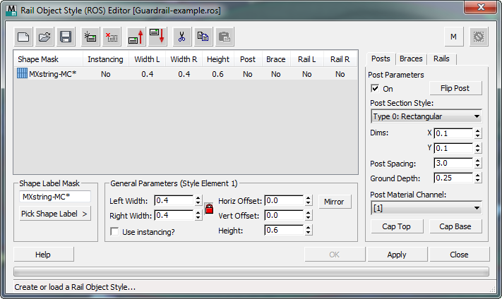

The Rail Object Style Editor associates a rail type with a series of shape label masks.

Interface
[rail object style element list]
Lists the contents of the current ROS style. Each line shows an individual element. When you highlight an element in the list, the General Parameters group and the rail element editor at the right display the settings of this element.

Shape Label Mask group
[text field]
Specifies a full or partial shape label mask (wildcard string). Civil View applies a rail object of this style to each shape in the scene whose name matches this mask.
Pick Shape Label
Click to turn on, then click in a viewport to pick a shape object. Civil View uses the name of the shape as the initial mask (wildcard) string.
Left Width / Right Width
Set the horizontal width from the center of the rail object to the left and right rails.
  • [lock] When on, the width values are locked and equal to each other. You can turn off the lock to have unequal widths. Default=on.
Use instancing?
When on, uses Civil View parameter instancing for rail objects created from the current style element.
For rail objects, this means that two highway guard rails of the same type can share a single instance of the parameters used to define the properties of that rail object. This is possible even if the guard rail lengths and paths are entirely different, since it is only the properties of rail profile itself that are instanced: not the geometry of the parent shape.
Hor[izontal] Offset / Ver[tical] Offset
Set the overall horizontal and vertical offsets of the rail object from the parent shape object.
  • Mirror When on, mirrors the Horizontal Offset by inverting its value.
    This is a useful way to convert a left-handed rail object to a right-handed version, and vice versa.
Height
Sets the overall height of the rail object from the base (normally ground level) to the center of the brace.
ROS Style Element Editor
At the right of the editor is a panel for editing rail object styles. It consists of three tabs, one for each of the rail object components: Posts, Braces, and Rails.
Posts Panel
On
When on, the rail object includes post geometry. When off, it does not.
Flip Post
Allows the post section to be flipped laterally (useful when using "Z" profile posts with guard rail).
Post Section Style
Specifies the type of post: either a rectangular section or a "Z" profile.
Dim[ension]s
Set the X and Y dimensions of the post.
Post Spacing
Sets the spacing between adjacent posts.
Ground Depth
Sets the depth of the post below ground level.
Post Material Channel
Chooses the material channel from the CivilViewRails material to apply to the post geometry.
Cap Top
When on, a geometric cap is placed on the top of the post.
Cap Base
When on, a geometric cap is placed on the bottom of the post.
