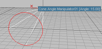

  2. In a viewport, move the mouse over the manipulator.
    The manipulator turns red when the mouse is over it and it is available to be manipulated. Also, a tooltip appears, showing the name of the manipulator and its current value.
  3. Drag the base of the cone angle manipulator's cone.
    The Angle value changes as you drag the manipulator. This value can range between 0.0 and 180.0.
