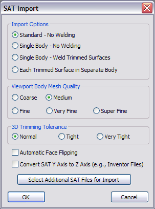

Import Options group
Choose how the importer treats incoming objects:
- Standard - No Welding This is the default option. Objects are imported separately, and are not be welded together. This option is usually the best for SAT files with solids.
- Single Body - No Welding Creates a single Body Object, but does not attempt to weld surfaces together.
- Single Body - Weld Trimmed Surfaces Creates a single Body Object with surfaces welded together. Use this option if your import file consists of one single entity (represented by multiple surfaces in the originating model) that you want to join together to eliminate seams or gaps.
- Each Trimmed Surface in Separate Body Imported trimmed surfaces are created as separate Body Objects. No welding is performed.
Viewport Body Mesh Quality group
The number of polygons used to represent the Body Objects in the viewports. The Coarse option uses relatively few polygons, while the other options create increasingly dense and precise meshes. The Fine options can take longer to import as a consequence.
3D Trimming Tolerance group
The permissible limit of variation in trimmed areas when creating and welding objects. The higher (tighter) the tolerance, the greater the accuracy of trimming.
This setting lets you adjust the import calculations to account for situations where the imported data is somewhat inaccurate. If there are errors, such as missing or poorly formed faces, after importing, try a different Tolerance setting to see if it helps the result.
- Automatic Face Flipping
- Automatically corrects surface normals that point inward. This feature attempts to unify the normals on an imported surface.
- Convert SAT Y Axis to Z Axis
- Converts the local coordinate system of models that are created in systems that use the Y axis as the up vector by rotating them so that Z is the up vector, as is the case in 3ds Max. This should be done for Inventor Files.
- Select Additional SAT Files for Import
- Allows you to import multiple files simultaneously using the current settings. The additional files should all reside in the same directory.
Use the file dialog that opens upon clicking the button to navigate to the directory, and then use the standard Shift+click or Ctrl+click method to select any number of files for import.
