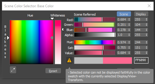

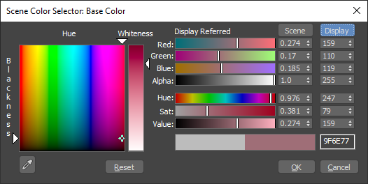

- For other colors, the numbers under Scene represent the color values in the rendering space in floating-point format, and the numbers under Display represent the equivalent colors in the display space (after the view transform and display encoding have been applied) as integers. Click either label to show the sliders in the corresponding space. The color transform that is used to convert between the rendering and display spaces depends on your Color Management Settings.
The dialog shows three different color selection models. You can use the controls of any model to define a color. As you adjust the controls of one color model, the controls of the other two models change to match. The three color models are:
- Hue/Whiteness/Blackness (HWB)
The HWB model represents a natural, pigment-based way of mixing color by starting with a pure color (hue) and then making it darker by adding black, or lighter by adding white.
The main feature of the HWB model is a large square box displaying the color spectrum. Across the top of this box is the spectrum of pure colors, or hue. Down the side of the box you see increasing levels of blackness, making the color dark as you approach the bottom.
To the right of the color spectrum box is the Whiteness box, which controls the amount of white in the color. Use higher positions to decrease the whiteness, or lower positions to increase the whiteness.
- Red/Green/Blue (RGB)
The RGB model adjusts the mix of red, green, and blue to define a color. This model represents the way colored light can be mixed. This is additive color mixing, as opposed to the subtractive color mixing for paint and other pigments. You can adjust values using the color sliders, the numeric fields to their right (via the keyboard), or the spinners to the right of the numeric fields.
- Hue/Sat (Saturation)/Value (HSV)
The HSV color model adjusts hue, saturation, and value. Hue sets the color; saturation (labeled Sat) sets the color's purity; and value sets the color's brightness, or intensity. You can adjust values using the color sliders, the numeric fields to their right (via the keyboard), or the spinners to the right of the numeric fields.
When using OCIO-based color management and setting colors in the Scene space, the sliders indicate colors that cannot be reproduced on your display using black stripes. You can still select these colors, and the display will show the closest possible screen color. In addition, a warning symbol appears — hover the pointer over the icon to see whether the color is outside the display gamut, the rendering gamut, or both.

- Hue/Blackness
Select a color by clicking anywhere in the box. To change the hue without affecting blackness or vice versa, drag the pointer along the top or left side of the box.
- Whiteness
The vertical bar to the right controls the amount of whiteness. The color set by the hue and blackness pointers is displayed at the top of the bar and pure white at the bottom. Drag the whiteness pointer down to lighten the color by adding white.
- Red, Green, and Blue
When a slider is all the way to the left, its numeric field contains 0; none of the color controlled by that slider is used. If the slider is all the way to the right, the maximum amount of that color is being used.
The spinners to the right of each slider are another way of setting the red, blue, or green component.
The colors in the sliders change to show an approximation of what the color result will be if you move the slider to that location, without adjusting any other color parameter.
- Hue
Sets the pure color. Locating the slider all the way to the left gives you pure red. As you drag the slider to the right you move through the spectrum of Red, Yellow, Green, Cyan, Blue, Magenta, and back to Red again.
- Sat (Saturation)
Sets the purity or strength of the color. A weak color, with a saturation near 0, is dull and gray. A color with high saturation is very strong and pure.
- Value
Sets the lightness or darkness of a color. Low values darken the color toward black. High values lighten the color toward white. A value in the middle gives you the color defined only by hue and saturation.
