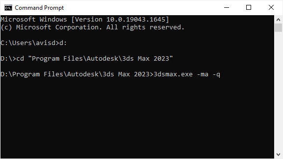

Start 3ds Max from the Command Line
To start 3ds Max from the Command Line
  1. Open a Command Prompt window ( Start Run).
  2. Navigate to the 3ds Max root directory.
  3. Type 3dsmax to start the program.
    You can use command-line switches to change various settings.
Note: In addition to the Command Prompt window, you can include the command line in a batch file.
