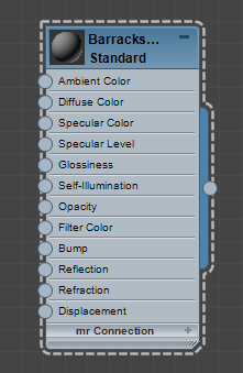

Building with default materials
Node for a single Standard material

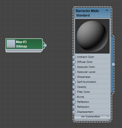

Planks bitmap for the wall texture
A Bitmap node added to the active View

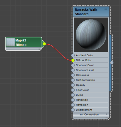

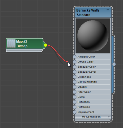

Dragging from the output socket of the Bitmap node creates a wire.
Dropping the wire on the Diffuse Color input socket applies that map to the material’s diffuse color component.

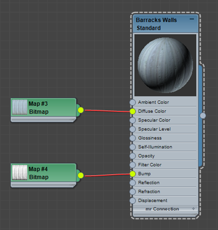

- Apply a map to the material’s Bump component (the bump map).
Bitmap for adding bumps to the plank material
.(This is simply the same image saved as black-and-white.)
Bump map added to the material tree
