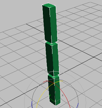

Rotating Multiple Linked Objects
When rotating a chain of linked objects (that is, a hierarchy) with Use Pivot Point Center active, the rotation is applied equally to each object in the chain. This results in a accumulated rotations, which makes it easy to animate such effects as fingers curling.
Hierarchy before rotation (parent at bottom)
Hierarchy rotated
