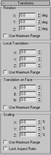

Transforms rollout
The settings in the Transforms rollout let you apply random transform offsets to each duplicate object. The values in the transform fields specify a maximum offset value that's applied randomly with a positive or negative value to each duplicate. Thus, if you set a rotation angle of 15 degrees, duplicates are rotated randomly from –15 to +15 degrees. For example, one duplicate might be rotated 8 degrees, another –13, another 5, and so on. You can use the Transform settings with or without a distribution object. When there is no distribution object, you must adjust the Transform settings in order to see the duplicates.
Rotation group
Specifies random rotation offsets.
- X, Y, Z deg
- Enter the maximum random rotational offset you want about the local X, Y, or Z axis of each duplicate.
- Use Maximum Range
- When on, forces all three settings to match the maximum value. The other two settings become disabled, and the setting containing the maximum value remains enabled.
Local Translation group
Specifies translation of the duplicates along their local axes.
- X, Y, Z
- Enter the maximum random movement you want along the X, Y, or Z axis of each duplicate.
- Use Maximum Range
Translation on Face group
Lets you specify the translation of duplicates along barycentric face coordinates of the associate face in the distribution object. These settings have no effect if you're not using a distribution object.
- A, B, N
- The first two settings specify the barycentric coordinates on the surface of the face, while the N setting sets the offset along the normal of the face.
- Use Maximum Range
Scaling group
Lets you specify the scaling of duplicates along their local axes.
- X, Y, Z %
- Specifies the percent of random scaling along the X, Y, or Z axis of each duplicate.
- Use Maximum Range
- When on, forces all three settings to match the maximum value. The other two settings become disabled, and the one containing the maximum value remains enabled.
- Lock Aspect Ratio
- When on, maintains the original aspect ratio of the source object. Typically, this provides uniform scaling of duplicates. When Lock Aspect Ratio is off, and any of the X, Y, and Z settings contain values greater than 0, the result is non-uniform scaling of duplicates because the values represent random scaling offsets in both positive and negative directions.
