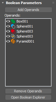

Boolean Parameters rollout
Example with operands and their operation icons
- Add Operands button
- Click to add an operand to the compound object from either the viewport or scene explorer.
- Operands list
- Displays the operands of the compound object. Colored icons show the current Boolean operation as shown in the Operand Parameters rollout. Visibility of each operand can be toggled on and off by clicking the eye icon.
You can right-click an operand to access the following commands: Remove Operand, Create New Boolean, Rename, Disable, and Solo. Use Create New Boolean to create sub-Booleans within the compound object.
- Remove Operands
- Removes the selected operands from the compound object.
- Open Boolean Explorer
- Opens the Boolean Explorer window. See Boolean Explorer for more information.
