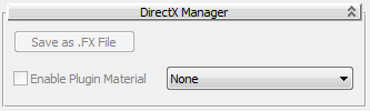

Interface
- Save as .FX File
Click to display a Save Effect File dialog that lets you save the active material as an FX file.
- Enable Plugin Material
Turn on to use the chosen DirectX shader in shaded viewports. Default=off.
When not enabled, viewports continue to use the default viewport (interactive) renderer (or the ActiveShade renderer, if that has been chosen).
This toggle is unavailable if no shader plug-in has been chosen from the drop-down list.
- Plug-in drop-down list
Use the drop-down list to choose a DirectX viewport shader.
