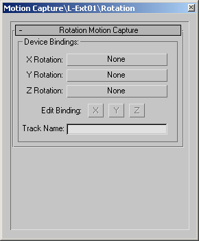

To specify a device:
- Click the Properties button while the Rotation track is selected.
The Properties dialog for rotation motion capture includes three binding buttons (one for each axis.)
- Click the Y Rotation button. In the resulting dialog, choose Mouse Input Device, and click OK.
The lower half of the Properties dialog display controls specific to the new device. Assuming this is a segment that isn't attached to another object, you want the horizontal mouse movement.
- Under Mouse Input, choose Horizontal.
The Scale spinner lets you adjust the relative effect of the mouse movement to the rotation. Flip reverses the rotational direction with respect to the mouse movement.

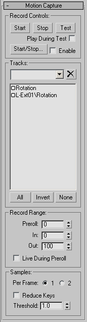

Motion Capture rollout
Record Controls group
Tests and records your animation. The first three buttons let you control the recording directly, while the Start/Stop button lets you use a MIDI device to control the recording.
- Start
- Starts a recording using the values set under Record Range below the Track list.
- Stop
- Stops the recording before the Out frame is reached. You can also stop a recording by pressing Esc or by clicking the right mouse button. Esc cancels the recording and does not save keys, while right-click commits the recording and saves the keys that have been recorded up to that point.
- Test
- Tests your motion. No recording takes place. Exit by clicking Test again, pressing Esc, or clicking the right mouse button.
- Play During Test
- When turned on, and you click Test, the animation in the scene plays in a loop while you test your motion. Note that tracks in the Motion Capture list that are selected (marked red) won’t play back because they're waiting for input from the assigned peripheral device.
- Start/Stop
- Displays the Start/Stop Trigger Setup dialog. You can choose the type of MIDI device that will control the recording.
- Enable
- Uses the assigned MIDI device for recording instead of the Start, Stop, and Test buttons. Tip: In the Time Configuration dialog, you can reduce the viewport playback speed, test or record at the lower speed, and then reset the speed to normal to view the results.
Tracks group
The Tracks area displays all tracks that have been assigned Motion Capture controllers. You select the tracks that will be affected by the three buttons in the Record Controls group. Click a track to toggle its selection box on or off. Only the selected tracks displaying the red box are affected by the Record Controls group.
You can select the tracks either by clicking them, or by using the All, Invert, None buttons. In addition, you can create named selection sets of tracks. To create a named selection, click the tracks you want, and then enter a name in the Edit field above the track list. To select a previously named set, open the Edit window, and select it from the list. To delete a named set, select it from the list, and then click
(Delete) at the right.
- All
- Assigns all tracks to the Record Controls group.
- Invert
- When tracks are selected, assigns the unselected tracks to the Record Controls Area.
- None
- Assigns none of the tracks to the Record Controls group.
By default, each track is provided a name consisting of the name of the object followed by a backslash and the name of the parameter. For example, Sphere01\Angle is an Angle parameter applied to one of the modifiers assigned to a sphere. You can rename the tracks in the Properties dialog, which you can access in Track View, or by double-clicking the track name in the Motion Capture utility. The upper rollout of each Properties dialog includes a Track Name field. Any name entered in the Track Name field appears in the Track list in the command panel, in the title bar of the Properties dialog, and beside the Data track in the Hierarchy list in Track View.
Record Range group
Specifies the frame range affected by the recording. You can also set a preroll range of frames (see below).
- Preroll
- Specifies the frame number where the animation begins playing when you press the Start button. If this number is the same or greater than the In number, the Preroll number is ignored. For example, if In: 0 and Out: 200, then a Preroll of -100 would give you 100 frames before the recording started, while a Preroll of 50 would be meaningless. If the range defined by Preroll and Out is larger than the current segment, the segment is temporarily enlarged during the recording.
- In
- Specifies the frame number where the recording begins after you click Start.
- Out
- Specifies the frame number where the recording ends after you click Start. You can stop the recording before this by clicking Stop.
- Live During Preroll
- When this is active, the motion capture is live through the preroll frames. The motion occurs, but isn't recorded. This can cause sudden motion shifts at the In frame because your live motion might not match the animation when you reach the In frame. When this option is inactive, the motion is disabled or frozen until you reach the In frame.
Samples group
When the motion data is captured, it’s sampled at a rate relative to the current frame rate, which defaults to 30 frames per second. Increasing the frame rate increases the sample rate.
- Per Frame
- These two radio buttons allow you to choose one or two samples per frame. This is a shortcut that lets you sample at a field rate. If you're rendering to fields, you don't need to capture at 60 frames per second. Controllers will interpolate between the samples.
- Reduce Keys
- Reduces the keys generated by the motion capture.
- Threshold
- The value you enter in the Threshold field constrains how 3ds Max changes the selected track. The difference between the new animation and the original animation, at any frame, will be less than the threshold value.
Low threshold values closely match the original animation but may not greatly reduce the number of keys.
High threshold values produce the fewest keys but may not match the original animation with much accuracy.
Note: When Reduce Keys is active, there is additional calculation time after each completed recording.

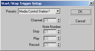

- Presets
- Choose the type of MIDI device. If you choose Media Control Station 2, you can use its buttons to Stop, Play, and Record. (The Media Control Station is a MIDI device containing standard VCR-style playback buttons along with a jog wheel.) By choosing Custom, you enable the remaining spinners in the dialog, where you can set specific channels and note numbers. You can also use Custom to customize the controls used by the Media Control Station.
- Channel
- Specifies the channel to which your MIDI device is assigned.
- Note Number
- The Stop, Play, and Record spinners that follow this label let you specify which note event triggers which function.
- Stop This note event stops the playback or the recording. On the Media Control Station, this would be the square button. This is the equivalent of clicking the Stop button under the Record Controls group.
- Play Plays the animation. This is the arrow button on the Media Control Station.
- Record When this note is sent by itself, it's the equivalent of clicking the Test button under Record Controls. To record the motion capture, you must press both Play and Record at the same time (the equivalent of clicking the Start button under Record Controls). You can press the Play button before or after the Record button and release the Play button before or after the Record button. The recording starts when the button is released.

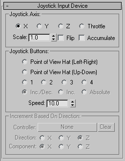

Joystick Input Device rollout
The Joystick Input Device driver was designed for the Microsoft Sidewinder joystick, which contains more controls than the standard joystick. You can use this device driver for standard joysticks as well.
Joystick Axis group
- X, Y, Z
- Specifies which joystick direction drives the animation. (Standard joysticks provide X and Y axes only. The Sidewinder provides the Z axis when you twist the joystick.)
- Throttle
- On the Sidewinder, this is a slider next to the stick.
- Scale
- Scales the relative effect of the joystick action to the animation response. (Spinner Value: float, 0 to 999,999.)
- Flip
- Flips the direction of the response.
- Accumulate
- When turned off, the joystick position represents an absolute position, and you're limited to the "rectangle" defined by the limits of the joystick. When the joystick returns to its rest position, the value generated returns to zero. When this is turned on, the joystick represents a change in the current position. Moving the joystick forward, for example, can cause an object to start moving, and it will continue to move until you return the joystick to its rest position.
Joystick Buttons group
- Point-of-View Hat (Left-Right, Up-Down)
- The Sidewinder includes a mini-joystick on the tip of the main joystick. Specify the direction this joystick controls in the animation.
- 1, 2, 3, 4
- Specifies one of four buttons in the Sidewinder joystick. They work similarly to the Point-of-View Hat, except that each button increases a direction value only while pressed. When you release the button, the value returns to zero (centered).
- Inc./Dec.
- One of three options available only when you choose one of the numbered joystick button options. This option (Increment/Decrement) means that the value is incremented when the button is down, and decremented when the button is up.
- Inc.
- When turned on, the value increments when the button is down, and stays at that value when you release the button.
- Absolute
- When turned on, the assigned parameters jumps to the value set in the Speed spinner when the button is down, and then jumps back to zero when you release the button. Use this for on/off animations, such as blinking lights.
- Speed
- Controls the rate at which the value changes when using either the Point-of-View Hat or the four buttons. When using a button option and the Absolute option, this specifies the value output when you press the button. (Spinner Value: float, –999,999 to 999,999.)
Increment Based On Direction group
Provides controls that let you derive the direction of movement from a Rotation controller. These options are used primarily when you're animating a first-person flythrough (such as when controlling a camera).
- Controller
- Assigns a Rotation controller from which the direction will be derived.
- Clear
- Removes the assigned controller.
- Direction X/Y/Z
- Specifies the local axis that will be used as the direction. For a Free Camera, for example, this would be Z because the camera points in the Z direction. However, if you had a car that pointed along its Y axis, you'd use Y.
- Component X/Y/Z
- Specifies the edit binding to use. Match this to the Edit Binding button under Device Bindings. For example, if the Y Edit Binding button is selected, choose the Y Component option.
