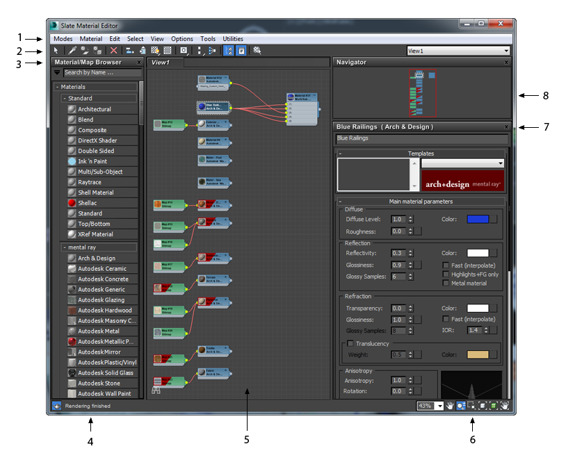

The Slate interface is a graphical interface with several elements. Most prominent are the Material/Map Browser, where you can browse for materials, maps, and base material and map types; the active View, where you can combine materials and maps; and the Parameter Editor, where you can change material and map settings.
1. Menu bar
2. Toolbar
3. Material/Map Browser
4. Status
5. Active View
6. View navigation
7. Parameter Editor
8. Navigator
The main visual elements of this interface are where you do most of your work:
  • Material/Map Browser
    This panel shows the Material/Map Browser. To edit a material, drag it from the Material/Map Browser panel to the View. To create a new material or map, drag it from the Materials group or the Maps group. You can also double-click a Material/Map Browser entry to add that material or map to the active View.
  • Active View
    The active View is where you construct material trees by wiring maps or controllers to material components.
    You can create a number of Views for the materials in your scene, and choose the active View from among them.
  • Parameter Editor
    The Parameter Editor is where you adjust detailed settings for maps and materials.
