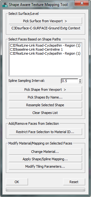

Select Surface/Level group
Pick Surface from Viewport
Click to turn on, then select the surface in a viewport.
[surface name]
Displays the name of the surface you select.
Select Faces Based on Shape Paths group
These controls let you select one or more shape objects from the current 3ds Max scene.  The shapes you select are used for two purposes:
  • To determine which faces on the surface will have texture-mapping modifications applied.  All faces that cross the path of the shape are selected, taking into account the Spline Sampling Interval described below.
  • To determine the direction in which texture mapping is applied.
[shape path list]
Lists the shapes you have selected.

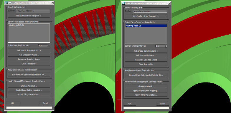

Resample Selected Shape
If some faces are not selected successfully when you first add a shape to the list, reduce the value of Spline Sampling Interval, then click this button to have a second attempt at selecting faces along the path of the shape.
Left: Faces omitted because the Spline Sampling Interval is too large
Right: Reducing the value of the Spline Sampling Interval selects all faces along the shape.

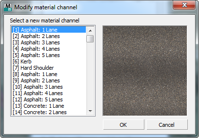

Change Material
Click to display a dialog that lists material IDs and lets you choose a new sub-material for the selected faces.

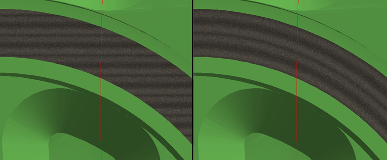

Apply Shape/Spline Mapping
Click to re-orient the texture mapping so it follows the direction of the shape.
Left: Texture not aligned with the shape
Right: Apply Shape/Spline Mapping aligns the texture correctly.
