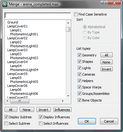

Merging Corrupt Files
If you can access the Merge dialog, use it to view a list of the components in the scene. This helps to locate the corrupted object that is causing the load failure. Once you find the corrupted object, exclude it from the file and resave.
To use the Merge menu to locate corrupted objects:
- Start 3ds Max.
- Choose File
Import
Merge.
The Merge dialog and shows every component in the scene.
- Select the model, click Open, and see if any of the objects or shapes in the scene are corrupt.
- In the List Types group on the right, turn off all options except Geometry, Shapes, and Groups/Assemblies.
- Click
All, and then
OK.
If the objects appear in the Viewport, it means that those scene components are not corrupt.
- Now, do these steps again with other List Types turned on.
When the objects merge successfully, save what you've merged ao you can use it to rebuild the scene. If you are still receiving an error message, it means one of the objects is corrupted. Do the following to locate which object in the list is corrupt. .
- Reset 3ds Max.
- Choose File
Merge again. and turn off everything except
Geometry,
Shapes, and
Groups/Assemblies.
- This time, select the first
ten objects in the list of components and click OK.
If those objects merge successfully, save the scene and repeat this process with the next set of 10 objects.
- Continue to go through the objects in your scene until you have located the object that reports the error.
- Once you've found the corrupt object, reset 3ds Max and merge all the objects and components but not the corrupted object that you found.
- After everything is merged, save the scene and rebuild the object that was corrupt.
