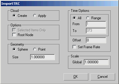

Cloud group
- Create (The default.) Choose this option to build a new set of marker objects.
- Apply Choose this option to map the incoming data onto the marker children of the selected root in your scene. Note: The marker objects must be named to match the imported data.
Options group
- Selected Items Only
- Imports the motion data only relative to the selected objects in your scene. Available only if the Apply option (in the Cloud group) is active.
- Root Node
- Includes a root dummy on file import. Available only if the Create option (in the Cloud group) is active.
Geometry group
These settings are available only if the Create option (in the Cloud group) is active.
- Sphere/Point
- Choose between creating spheres or point helpers to illustrate markers.
- Size
- Sets the sphere diameter or point size, based on your choice above.
Time Options group
- All/Range
- Choose between using the entire animation range from the motion capture file, or a defined portion of the range.
- To/From These values represent the start and end frames of the defined range. Available only if Range is active.
- Offset
- Sets the number of inserted empty frames before the imported animation starts.
- Set Frame Rate
- When on, the frame rate from the TRC file overwrites the current one in the Time Configuration dialog.
Scale group
- Global
- Sets the size of the resulting skeleton. Note: The scale value within 3ds Max remains 100.
