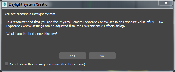

Whichever method you use, if you add a Daylight system while no exposure control method is in effect, 3ds Max automatically prompts you to apply an appropriate exposure control. Always use the exposure control that’s best suited to the current renderer:
Renderer Recommended Exposure Control Default Scanline Logarithmic Quicksilver Physical Camera - Choose a viewport in which to create a compass rose (the compass direction of your "world"). This should be a Top or Perspective/Camera view.

Daylight System, and when prompted to add an exposure control, click Yes. Add the Daylight system in a viewport.

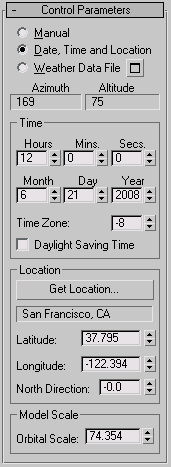

Control Parameters rollout
This rollout appears on the Create panel, and on the Motion panel when the light component of the Daylight or Sunlight system is selected.
[control source radio buttons] (Daylight system only)
- Manual When chosen, you can manually adjust the location of the sun object in your scene, as well as the intensity value of the sun object.
- Date, Time and Location When chosen, daylight uses the geographically correct angle and movement of the sun over the earth at a given location.
Note: When Date, Time And Location is active, adjusting the light's intensity has no effect.
- Weather Data File When chosen, daylight derives the angle and intensity of the sun from a weather data (EPW) file.
Click the button to open a
Configure Weather Data dialog, where you can specify the EPW file and choose which weather data you want the daylight system to use.
- Azimuth and Altitude
Display the azimuth and altitude of the sun. Azimuth is the compass direction of the sun in degrees (North=0, East=90). Altitude is the height of the sun above the horizon in degrees (Sunrise or Sunset=0).
Time group
Provides settings for the time, date, and time zone.
If the location you choose uses Daylight Savings Time, turn on the Daylight Saving Time checkbox. The Sunlight system adjusts the sun's azimuth and altitude accordingly during the summer months.
- Hours/Mins/Secs
- Specify the time of day.
- Month/Day/Year
- Specify the date.
- Time Zone
- Time zones range from –12 to 12. If you're uncertain about a time zone, you can look them up in Window's Date
Time Properties dialog (available through My Computer
Control Panel
Date
Time). Click the Time Zone tab, and then display the list of world locations and their time zones. - Daylight Savings Time
- When on, calculates daylight savings by adjusting azimuth and altitude during the summer months.
Location group
Provides controls for setting the location of your scene in the world.
- Get Location
- Displays the
Geographic Location dialog, which lets you set the latitude and longitude values by selecting a location from a map or a list of cities.
Note: For precise locations, enter exact coordinates using Latitude/Longitude.
- [city name text box]
- Displays the name of the city you choose from the Geographic Location dialog. If you adjust the Latitude or Longitude spinners after choosing a location, this area becomes blank.
- Latitude/Longitude
- Specify the location based on the latitude and longitude.
Note: Negative longitude values are west of the Greenwich meridian; positive values are to the east of the meridian. This differs from versions prior to 3ds Max 2009, in which the polarity of longitude values was incorrectly reversed.
- North Direction
- Sets the rotational direction of the compass rose in the scene. This is the geographical orientation of the compass rose. By default, north is 0 and points along the positive Y axis of the ground plane. Positive X (East) is 90 degrees. Adjust the North Direction to correspond to your site. Accuracy of the system depends on this correspondence.
Model Scale group
- Orbital Scale
- Sets the distance of the sun (the directional light) from the compass rose. Because a directional light casts parallel beams, this distance has no effect on the accuracy of the sunlight. However, the light must point toward your model (not away from it), and the light's hotspot and falloff do have an effect.
The best way to ensure that the light is set up correctly is to change one viewport to the light's view (for example, Sun 01). Then adjust the light's location using Dolly, and set the hotspot so it illuminates the whole model, with no falloff.
