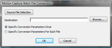

Motion Capture Batch File Conversion Dialog
Converts one or more CSM or BVH motion-capture files to filtered BIP format.
  • Create or select a biped. > Motion panel > Motion Capture rollout > (Batch File Conversion) > Motion Capture Batch File Conversion dialog
Interface
Source File Selection
Opens a dialog where you can specify motion-capture files to convert. Use Shift+click to select all contiguous files between the two that you click. Use Ctrl+click to add individual files to the selection.
Destination Directory
Specifies the directory in which to store the filtered files.
Specify Conversion Parameters ...
Lets you choose how to specify conversion parameters:
  • Specify Conversion Parameters Once Imported files use a single set of conversion parameters.
  • Specify Parameters For Each File You specify conversion parameters for each file.
