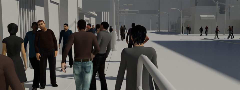

The Populate toolset lets you add animated characters to your scene quickly and easily. The characters can walk along paths, or flows, and others can hang out in idle areas or sit on seats. The flows can be as simple or as complex as you like, and can include shallow inclines and declines.
