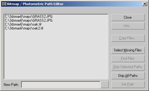

This dialog is the main part of the interface to the Bitmap / Photometric Path Editor utility.

Interface
- List of maps and photometric files
Shows all bitmaps and photometric files (IES, CIBSE, LTLI) used in the scene, along with their current path.
When no file is selected in the list, the only controls available in the dialog are Close, Select Missing Maps, and Strip All Paths.
- Close
Click to close the dialog.
- Info
Click to display a Resource Information dialog.
This button is available only when a single file is selected in the list.
Double-clicking a name in the list is another way to display the Resource Information dialog.
- Copy Files
Copies the selected files to a directory you choose. This button displays a Windows file dialog that lets you choose the destination directory.
- Select Missing Files
Highlights the names of missing files in the list.
- Find Files
Click to search for the maps or photometric files in the current selection. This button displays an alert that shows how many files are findable, how many files are missing.
- Strip Selected Paths
Click to strip the path from the selected files. An alert appears to warn you that the scene will lose this information.
- Strip All Paths
Click to strip the path from all files in the list. An alert appears to warn you that the scene will lose this information.
- Set Path
Click to apply the New Path field to the selected files.
If the New Path field is identical to the selected file or files, clicking Set Path clears New Path.
- New Path
Lets you enter a path for the currently selected file or files. Default=The path of the currently selected file, or none if multiple files with differing paths are selected.
[browse]-
(To the right of the New Path field.) Displays a Windows file dialog to let you browse for a path.
